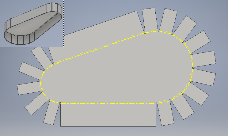

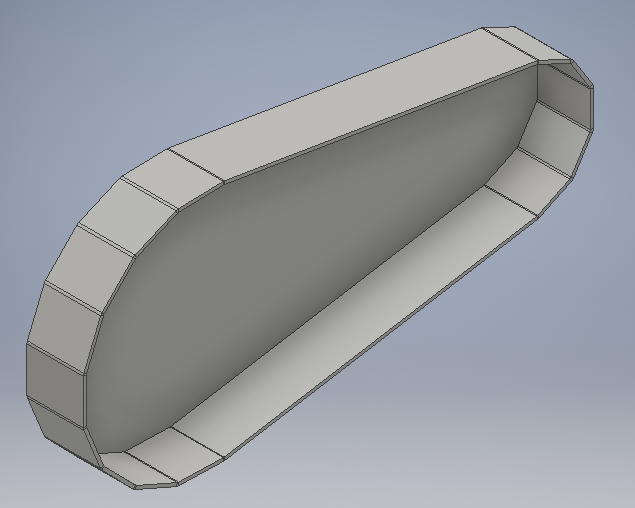

Not creating Flat pattern the way that I would like Any pointers?
I am trying to create a Chain guard with the Sheet metal .ipt
When I try and Create a flat pattern with this part, it doesn't work.
I'm sure that it is because of the way that I drew up the part.
Please review it and tell me where I went wrong?
Is there a tutorial recommendation?
Thanks
M0621017_Guard.ipt
Two main problems...
1. You need a Rip in the Lofted Flange
2. You can't build a Face on the bottom like you did.
You would be better off drawing the Face first with the curves of the shape drawn as line segments and then using the Flange Tool to create the flanges around the edge.
Got it.
At least that way It will flatten out.
I'll work on that.
Thanks
You will have fun pressing that, you might be better off doing the two ends as rolled semicircles with corner welds.
