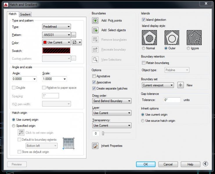

chrisdarmanin Posted January 28, 2016 Posted January 28, 2016 how do i get the ribbon hatch interface/toolbar to appear seperate from the ribbon? it slows the pc down every time i select a hatch and the ribbon changes to the hatch menu however i do like the ribbon Quote
ReMark Posted January 28, 2016 Posted January 28, 2016 (edited) Is this the interface you're looking for? Old school hatch dialog box... For anyone who would like to completely remove the hatch contextual tab completely read this... http://www.cad-notes.com/how-to-remove-hatch-contextual-tab-ribbon/ Edited January 28, 2016 by ReMark Quote
chrisdarmanin Posted January 28, 2016 Author Posted January 28, 2016 that's it, thanks, followed the tutorial Quote
rkmcswain Posted January 28, 2016 Posted January 28, 2016 how do i get the ribbon hatch interface/toolbar to appear seperate from the ribbon? it slows the pc down every time i select a hatch and the ribbon changes to the hatch menu however i do like the ribbon Set HPDLGMODE = 1 to force the dialog box to show when you run HATCH or GRADIENT. If you want to remove the contextual tab altogether, see: http://www.cad-notes.com/how-to-remove-hatch-contextual-tab-ribbon/ Quote
SAFeSTeR Posted February 1, 2016 Posted February 1, 2016 I used to dislike the hatch contextual tab so I would press 'T' after starting the command, as this opens the hatch dialogue box. Quote
