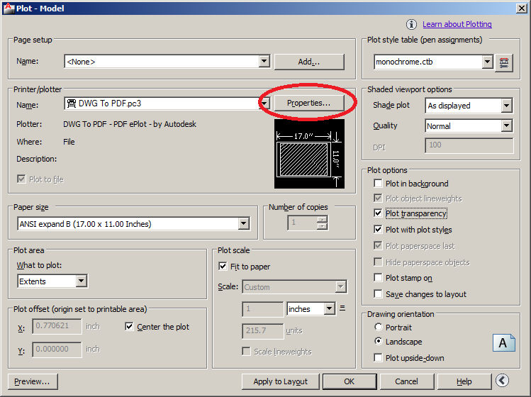

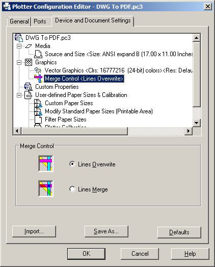

SLW210 Posted January 29, 2016 Posted January 29, 2016 Are you plotting with the AutoCAD DWG to PDF.pc3 in the plot manager? Usually, if the preview looks correct, the problem is with properties settings in the Plotter/Printer itself. It would help a lot if you could show some screen shots of the plot settings and provide enough of the drawing to indicate the problem. Quote

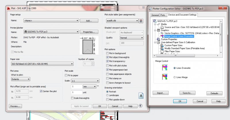

buttonbutton Posted January 29, 2016 Author Posted January 29, 2016 merge control was the same as what you posted but ..yes am plotting DWG to PDF.pc3 ... (kinda) I copied that output then modified it to push out the printable area by adjusting the margins .... but I have noticed that if I use the default (unmodified) dwg to pdf.pc3 it works perfect ! (only need to resize my layouts now) ... I must has modified it in the settings but cant seem to find any option relating to transparency in those settings .. thanks again for pointing me in the right direction Quote

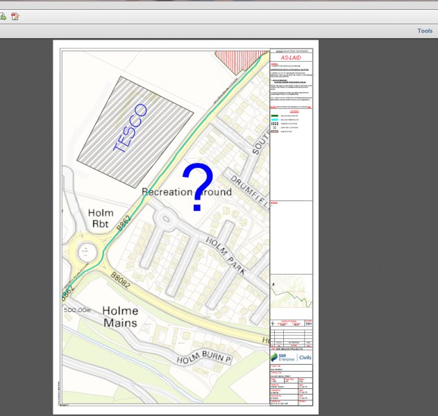

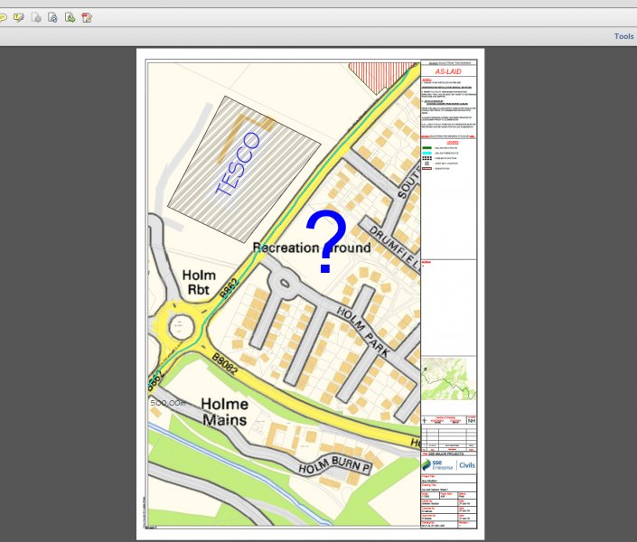

buttonbutton Posted January 29, 2016 Author Posted January 29, 2016 this is what it looks like and what am needing it to look like .. the big blue ? is a query I have relating to the drawing .... as you can see I have a second viewport incorporated in the layout that I want to keep bold the fail looks too cartoonish and obscures the data am trying to present .. cant post the dwg Quote

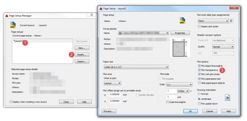

rkmcswain Posted January 29, 2016 Posted January 29, 2016 .... but I have noticed that if I use the default (unmodified) dwg to pdf.pc3 it works perfect ! (only need to resize my layouts now) ... I must has modified it in the settings but cant seem to find any option relating to transparency Whether or not transparency is enabled is saved in the Page Setup. Find your layout. Right-click on the layout tab and click on Page Setup Manager Choose the current page setup from the list and click Modify. Is "Plot Transparency" checked ON? After you verify this, click OK, and close. Now run the PREVIEW command. Does it look right? Quote
