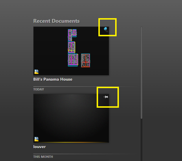

Are they pinned? If the pushpin is blue. they are pinned. Click the pin to pin or unpin them. See image below.
If they are pinned, they will stay at the top of the list. If they are not pinned, they will be replaced by more recent files as you use them.

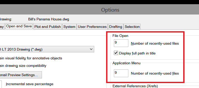

On your (command) OPTIONS dialog, reduce the count for Recent Files. Then they will be replaced by more recent files, more frequently. See the other image below.
