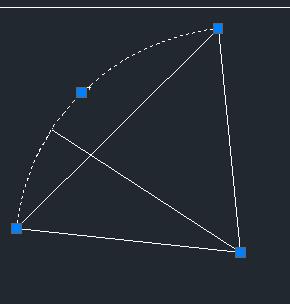

KendiKong Posted February 3, 2016 Posted February 3, 2016 What is the correct syntax for creating a shape that has an arched side. I will be using getpoint for getting the coordinates of the corners. I want to create the arc using a 3 point arc command and the whole shape should be joined as one. I tried the "pline" command, and then doing "arc", but it uses 2 point and radius instead of 3 point. And the other thing is, once I get this shape by drawing lines from the coordinates that I picked on the screen, how do I dimension the arc? I do not want to use ssget because that requires me to click the arc. I want my code to save me the trouble of clicking any more than I need to. I tried to use command dimradius and then specifying a coordinate on my arch, but the problem is, its not exact and autocad cannot find the arch. Quote

KendiKong Posted February 4, 2016 Author Posted February 4, 2016 Yes, but how do I define my arc, if I cannot specify the arc by coordinates. Quote

KendiKong Posted February 7, 2016 Author Posted February 7, 2016 OK. For instance something like this example , my code offsets a shape outward, and now I just need to dimension the radius of the cyan arc. How would I even point to the arcs location. I have tried using explode on my shape, and then using (setq arcselect (ssget "b" pointa pointb)) and being a noob, I cant even get this to work for some reason. I tried "w" as well and making the selection rectangle enclose the entire arc, and it still doesnt work. I hate being stuck on something that seems so simple. Quote
BIGAL Posted February 8, 2016 Posted February 8, 2016 Go back to your other post where the answer was posted make it a pline and use lee-macs pline routine to get the properties that you can use to create the dimensions via a lisp. Have a look at last page of this post http://www.cadtutor.net/forum/showthread.php?27634-Auto-dimesioning-polyline/page9 Quote
KendiKong Posted February 8, 2016 Author Posted February 8, 2016 Go back to your other post where the answer was posted make it a pline and use lee-macs pline routine to get the properties that you can use to create the dimensions via a lisp. Have a look at last page of this post http://www.cadtutor.net/forum/showthread.php?27634-Auto-dimesioning-polyline/page9 If you are referring to polyline information program, that does not really best solve my problem. Like i said my code is designed to perform offset and dimensioning using only the input of the original shapes coordinates and nothing else. All I would need right now is to figure out how autocad can select my offsetted arc properly. Quote
BIGAL Posted February 8, 2016 Posted February 8, 2016 (entlast) !!!!! then pass to lee-mac program dont know how many times I must post the same answer !!!! Quote
