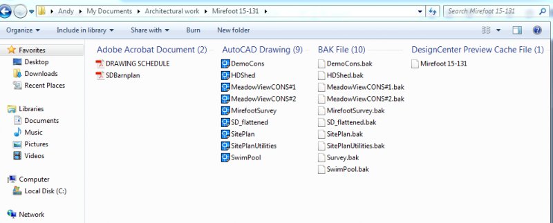

andybeedub Posted February 5, 2016 Posted February 5, 2016 Hi I use the design centre quite a lot (still on 2002 version) Each time the system saves a file onto the main folder, this inserts itself and gets in the way interfering with my currently neat file stack So i frequently end up deleting this new unwanted folder I've looked thru to see how to stop it creating this folder but to no avail, also searched on these forums for answer Any help would be much appreciated cheers andy Quote

andybeedub Posted February 5, 2016 Author Posted February 5, 2016 Hi Yes I can see it wasn't very well explained In the top right is the Design Centre preview Cache column this is what I want to avoid saving It happens when the DC is open and the dwg is saved cheers Quote

ReMark Posted February 5, 2016 Posted February 5, 2016 That does not look like the Design Center to me. Looks more like Windows Explorer. And it looks pretty organized to me. Quote
andybeedub Posted February 5, 2016 Author Posted February 5, 2016 Yes it is WE on Windows 7 the column marked 'Design Centre Preview Cache' appears every time i use DC Its annoying thats all I would like to stop AutoCAD saving this folder each time Thanks Quote

SLW210 Posted February 8, 2016 Posted February 8, 2016 They are created when using Large Icon view in Design Center Browser, change it to something else. Quote
RobDraw Posted February 8, 2016 Posted February 8, 2016 Is it one of those files that "should" be deleted after the file is closed? Quote
SLW210 Posted February 8, 2016 Posted February 8, 2016 No, it just saves rebuilding the icon list when using Design Center, if deleted it will just rebuild the list. No idea why it is necessary for Large Icon and not the other views. Quote
