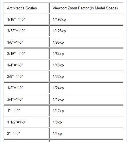

ReMark Posted February 9, 2016 Posted February 9, 2016 (edited) Maybe he is confusing scale with scale factors. Here's a list of actual scale factors for the most commonly used architectural scales. Note that if you want to use scale factors and avoid using the scalelist then you'll have to use the ZOOM command with the SCALE option. Edited February 9, 2016 by ReMark Quote
