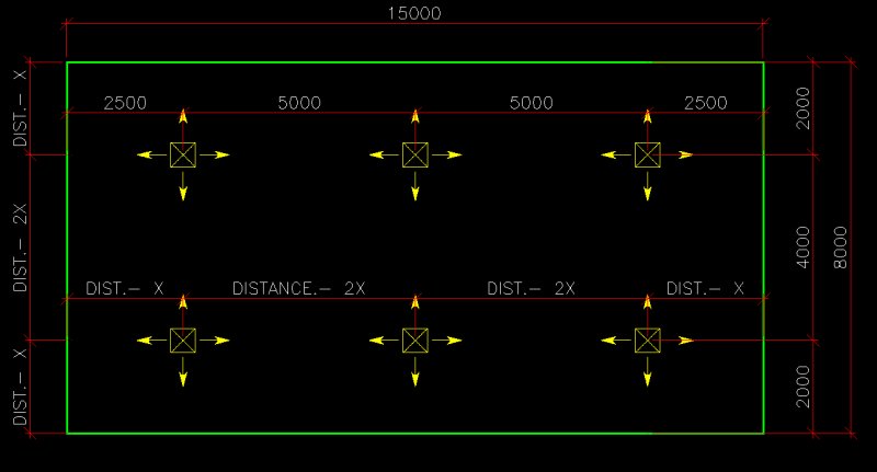

CAD USER Posted February 9, 2016 Posted February 9, 2016 Dear all, First of all sorry for my poor English…. I am HVAC Draftsman. For purpose of project designing (Meeting room, Bed rooms, Lounge, Hall etc.) I have to make square ceiling diffusersor, round diffusers in between distances X2X basis I don’t know how to create lisp routine. If someone help me to create lisp routine as I want, it will be greatly appriciated lisp routine will work in below stages Stage: 1 1) Two folders will be created to linked with lisp routine Folder no.1- Square Diffusers (it will carry different sizes of square diffusers like 6x6" , 9x9", 12x12" 15x15" and 21x21") Folder no.2- round diffusers (it will carry round diffusers like dia 6", 8" ,10", 12", 14", 16", 18", 20") Stage: 2 1) select area (bed room or hall) by window 2) then choose how many rows you need of diffusers (for example 3 rows) 3) then choose how many column you need of diffusers (for example 3 column) (in this case total no. of diffuser will be 6 in particular room divided in X 2 X sequence) 4) then which size of ceiling diffusers you want to insert. (for 6x6" square ceiling diffuser TYPE 6, for round ceiling diffuser TYPE R6) Thanks in advance.. Quote

CAD USER Posted February 10, 2016 Author Posted February 10, 2016 Dear all, I tried array but i m not getting as i want, it's consuming more time, and its not distributing X2X sequence, it's distributing equal spacing. Quote
CAD USER Posted February 10, 2016 Author Posted February 10, 2016 Please find attached pic, actually it will be look like this when it will be x2x distances. Quote
