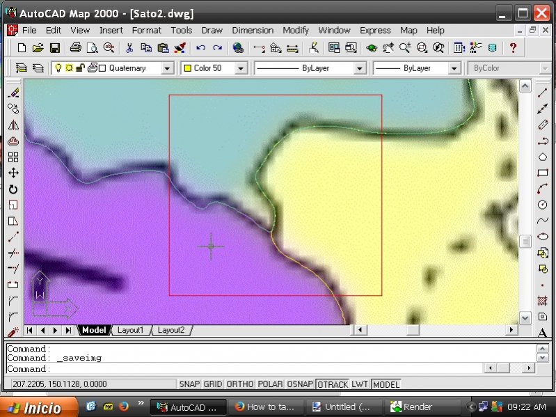

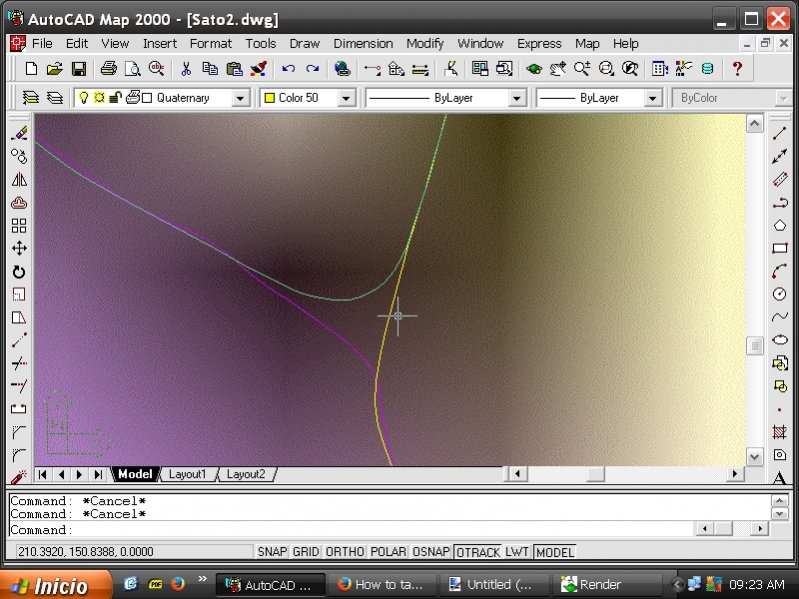

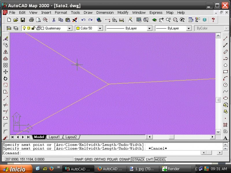

carloswm Posted February 10, 2016 Posted February 10, 2016 Hi, everyone! I'm making a map using AutoCAD Map 2000. Right now I'm trying to fix a triple limit as it is seen in this picture. In the distance it doesn't look bad, but when I zoom in this is what I see: What I want to do is to elimiate that empty space so I can see something like this: Thanks in advance. Quote

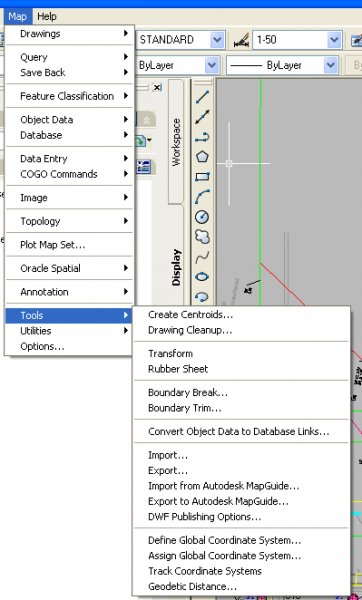

Murph_map Posted February 22, 2016 Posted February 22, 2016 How were those objects created and are they plines or polygons? Have you tried the Map/dwg cleanup tool? Under the Map menu > Tools > Drawing Cleanup in 2000 Version. Pick on the HELP button in the Edit Geometry section to read what each one does. You may also might want to make a backup of the dwg before using the tools it can cause some damage if you don't know what you are doing or follow directions. Quote

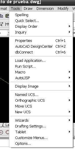

carloswm Posted March 1, 2016 Author Posted March 1, 2016 How were those objects created and are they plines or polygons? Have you tried the Map/dwg cleanup tool? Under the Map menu > Tools > Drawing Cleanup in 2000 Version. Pick on the HELP button in the Edit Geometry section to read what each one does. You may also might want to make a backup of the dwg before using the tools it can cause some damage if you don't know what you are doing or follow directions. Hi, Murph. Those objects are polylines. There is no such tool as the Drawing Cleanup tool in the AutoCAD Map 2000 I'm using. I'm attaching a screenshot of what I see. I installed the AutoCAD Express Tools, maybe that's why I can't see that tool. Thannks. Quote
eldon Posted March 1, 2016 Posted March 1, 2016 Perhaps you are looking at the wrong Tools Menu Quote
Murph_map Posted March 1, 2016 Posted March 1, 2016 Perhaps you are looking at the wrong Tools Menu Yes, the command is under the MAP Menu TOOL > . Quote
