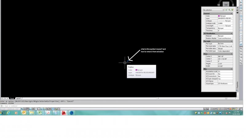

recently i have selecting poly line it shows some symbol,these symbols are disturbing the poly line selection.kindly please check the attachment for more info.

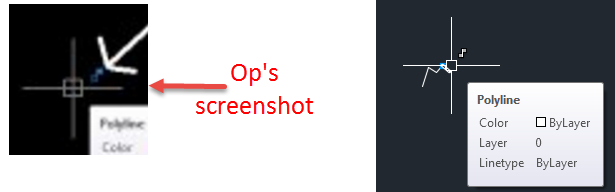

It is difficult to see but it looks like cursor badges. Look at the CURSORBADGE system variable.

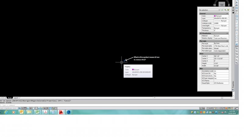

It looks like you are not in a command. If that is so, I don't think it is a cursor badge that is controlled by the CURSORBADGE variable. I'm thinking it might be indicating constraints. Can you get a better screenshot of it?

It looks to me like OP is hovering over something with constraints applied.
Run the DELCON command and select those objects and then when the command is done, hover over the polyline again.

Thank you for your effort.command is working properly.
