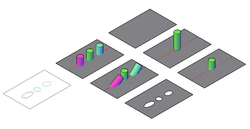

i need to use autocad to calculate out (so that i can print out 1: 1 scale) an resulting ellipse holes of a solid 12cm rod going thru a hollow sheet metal at an angle of 30 deg c and 45 deg c.

i draw a simple pic of how the assemble is.. but it is the resulting elipse hole that i need to print out.

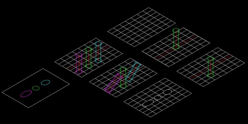

You might take an approach similar to this. I used a surface for my sheet metal and a solid for my rods. The first image was created using a 2D wireframe visual style.
Here is the same image created using a Conceptual visual style.
Red = centerline
Magenta = 30 deg cylinder
Green = 90 deg cylinder
Cyan = 45 deg cylinder
Created surface, added cylinders, rotated two of the cylinders (30 deg & 45 deg) subtracted cylinders from surface, exploded resultant surface to arrive at final solution containing two ellipses and one circle. Use Area command to obtain area.
The result of a solid cylinder subtracted from another solid.

If you want to use autocad to calculate the resulting ellipse, as you said, to find longer radius of the ellipse, for 30° angle, type this on command line:
(/ (/ 12.0 (sin (/ (* 30 pi) 180))) 2)
for 45° angle type:
(/ (/ 12.0 (sin (/ (* 45 pi) 180))) 2)
The shorter radius will of course be 6 in both cases.
