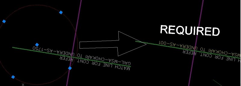

Sir, I have to measure Polyline at 1750 meters, and also put the chainage in the block. But I wanted serial No. instead of chainage.
Thank you
Which part of the attribute value represents the chainage?
So how would the outcome of the attribute value going to be? give one instance.
Dear sir,
Please see screenshot
So you want to insert that attributed block name: MATCH_LINE at every distance of 1750 and replace the distance value with increment number starts with 001 ?
that's right sir, increments block matchline number should be.
Try this.

Tharwat,
Thanks for your lisp code, it's great. Please you can add the option to polyline manually measure the distance.

Excellent, try this [uNTESTED] adds.

Hi Tharwat, You can add one more option. "GAIL-MSA-CHOKARI TO UNDERA-AS-" is the name of the drawing, so please add it manually option of asking.
