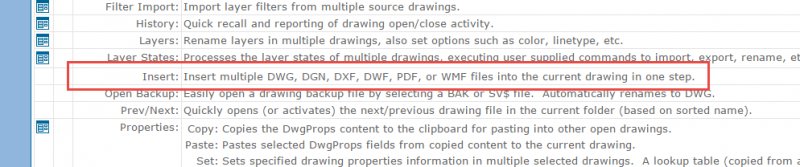

rkmcswain Posted February 16, 2016 Posted February 16, 2016 If you just want a ready made solution, this tool can do it. Quote
