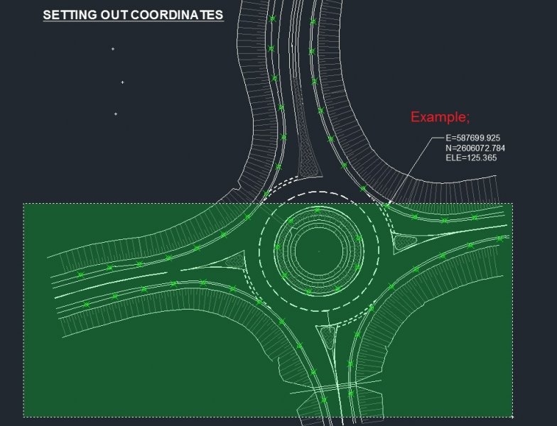

Dear all;
My end goal is to find a Lisp that will Auto-Labels X,Y,Z when u select points as shown Image Label Mtext with leader without overlapping
Thanks in advance for any help/advice
Siva

Alternate suggestion:
1. Create dynamic block, with reporting XYZ coordinates
2. Insert that block ontop of the pointslist
Create an attributed block with attribute values containing fields referencing the block insertion point.
You can then use my Point Manager program to insert such block at all points in a selection.
Oh yeah, I completely forgot about Lee's Point Manager - people who are labeling XYZ coordinates won't imagine living without it.
Many thanks Lee Mac for your suggestion to my thread
& thank Grrr
See you again
Siva

In some situation space problems & overlapping issues, to avoid that I prefer this way
Example of the Problem:
thanks
Siva
You have to redefine block DWG I posted... Just change position of attributes with fields - I think you can do this through command BEDIT.
