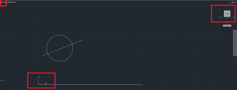

I'm trying trimming the circle cutted by a line, see in dwg file in attachment, but I can't do that .I'm working in front view, but the cube indicates top view.Circle and line are in xy plane, why trim didn't work, is it a bug?I type trim, I select the line so the circle, and it doesn't work.Note:I rotated the axes before.

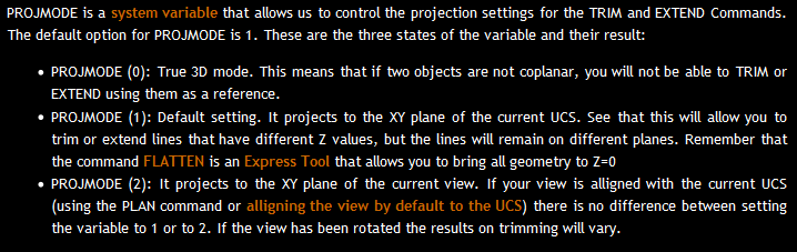

Tell us, what is the system variable PROJMODE set to at the moment?
Look at this (source: CAD Addict)...

Sorry for doing that . I liked so much the answers in previous post .I thought my question would be more suitable in beginer's area, since I don't assure that this is a bug.I won't do this anymore, I didn't know that is against the rules.
But the command should work, even projmode set zero, since circle and line are coplanar
Anyway, I tested what you suggest, you are very right.My "projmode" was set [0], when I turned It [1] I was able to trim the figure.Thank you, problem solved. =)

I mentioned PROJMODE in one of the other threads. I guess it wasn't the solution for the other very similar drawing.
