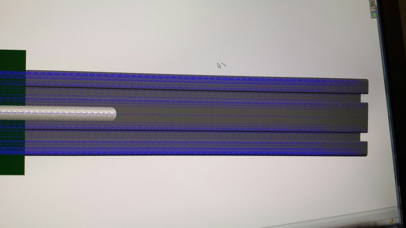

Having troubles trying to remove hidden lines in a part in assembly. tried right clicking on part. Tried even the component display option. icon9.gif

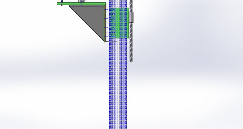

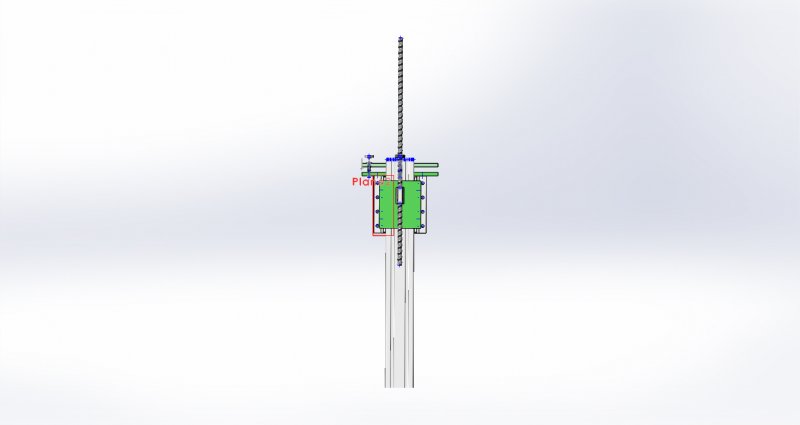

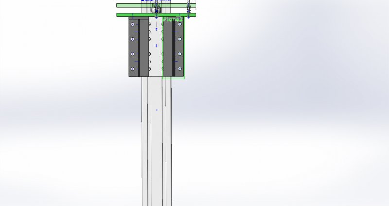

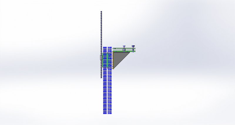

Sides show hidden lines and front and back doesn't.

in general blue lines are actually "curves" and not part of hidden lines. If you show hidden lines they won't be on a shaded model, and they will be dashed black lines. Do you have any curve data? Either projected curves, composite curves, helix etc? Its too small for me to tell what it is. You can use the view drop down from the top-center of the modeling window to hide all curves(green squiggly line in 2015 and older). or go to the View menu and deselect "curves".
The T slotted frame extrusion was downloaded from McMaster Carr. it is the hidden line in the extrusion and for some reason it shows up in two view? I got to looking through menu and on "View> Temporary Axes " was click on and it the hidden line.

Ok. Yeah those aren't hidden lines per say. Mcmaster parys seem to have random sketches visible and things like temporary axes shown. Just fyi any cylinder or cylindrical face(ie fillet) will have one. Any time you see something like that and its blue it will be some sort of reference geometry or curve data. If its black or grey it is a sketch. If its dashed then its hidden lines.
