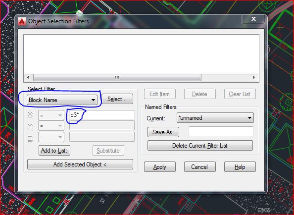

The Block Name option in the FILTERS dialog allows wildcards
In this example only blocks whose name starts c3 will be selected.
