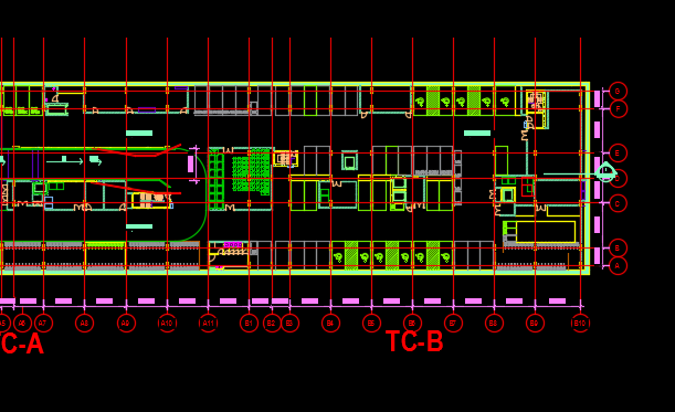

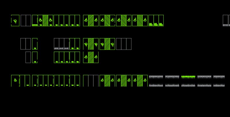

I have a question i am sure there is a simple answer for, but its escaped me.
I get architectural drawings, put them in as models as a background and draw over the top of them.
so i like to have the architectural model all grey, except maybe the grids.
however i find that the architectural s are made of many hundreds of blocks, and i have to edit each block and change the colour then save then repeat for another almost similar block.
there must be a way, besides exploding the whole drawing, to make it all grey.
Thanks in advance.
