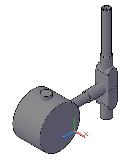

How would I go about turning a 2D isometric drawing into a 3D object? Is there a lisp routine out there that does that or can someone teach me how to do it? Please see attached drawing. I appreciate you taking the time out to read this. If this is the wrong forum to post this, can someone move it into correct one or tell me where to post.

There is no lisp routine that I know of that will turn your 2D isometric into a 3D model. The model would have to be created from scratch.
I roughed this out in 3D only as a demonstration. All dimensions are a figment of my imagination and are not an attempt to be accurate.
