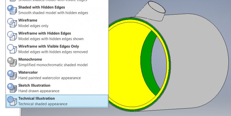

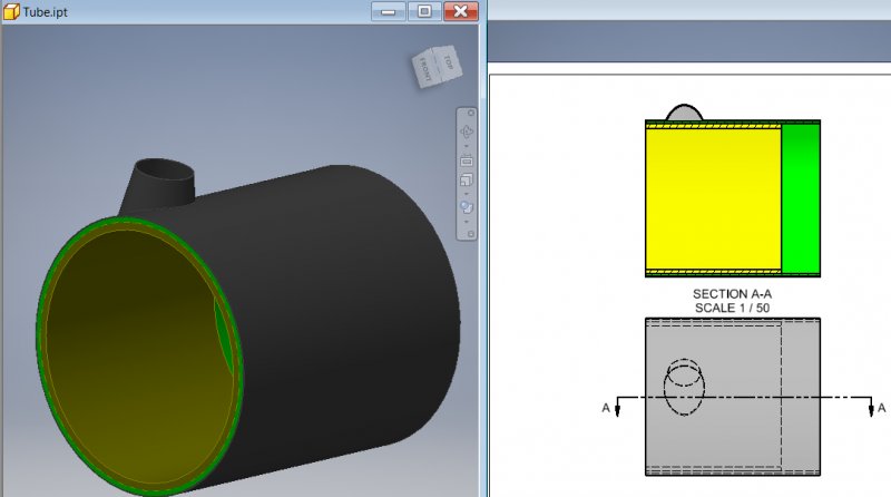

I got something to work with a few material settings...Not sure if it is a great method though as the models will appear dark. You would have to use Technical Illustration Visual Style all the time while modeling.
Here is your file as an example...saved in 2016 format.

This is the Technical Illustration Visual Style in 2016.
I have a case in at Autodesk to look at this further because I am only getting this to work in a migrated template of mine and not the default 2016 templates...sigh...
