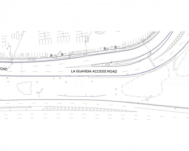

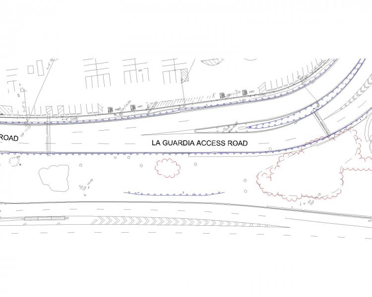

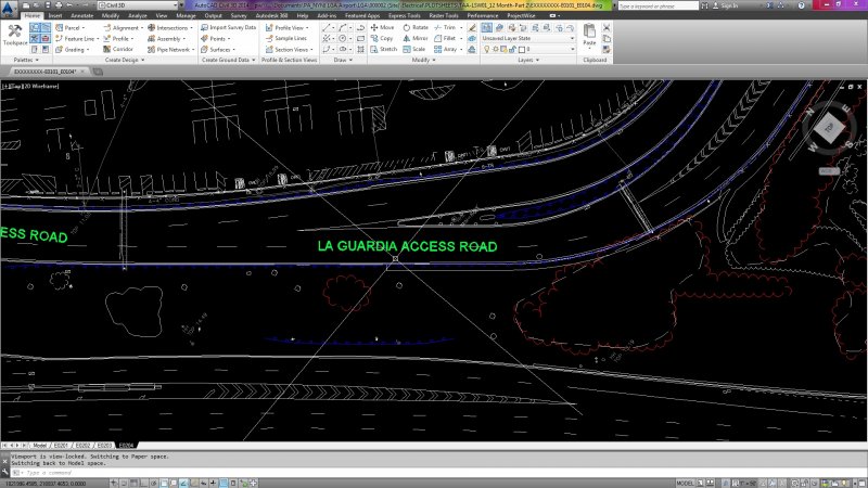

xrunnurx23 Posted March 16, 2016 Author Posted March 16, 2016 1st is the cad, blue guiderail & red tree line 2nd is a plot, they show up fine 3rd is the publish and it doesnt work!! I need to be able to publish because I have to hundreds of drawings at a time. Thanks! Quote
RobDraw Posted March 16, 2016 Posted March 16, 2016 I cannot view photobucket from work. Maybe this will help: http://www.cadtutor.net/forum/showthread.php?95160-How-to-upload-files-to-the-forum Quote
xrunnurx23 Posted March 16, 2016 Author Posted March 16, 2016 1st one is the cad the second is the plot, linetypes show fine, the box beam guide rail & treeline. the third is the publish, does not show the linetypes anymore. Beyond frustrated Quote
