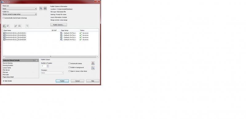

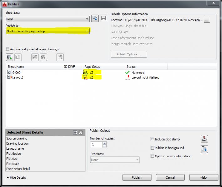

Are you using named page set-ups and verifying they are applied in publisher?
  • Replies 27
  • xrunnurx23
    12
  • RobDraw
    10
  • Grrr
    4
  • Organic
    1
Posted Images
Can you post a sample file that exhibits the behavior?
Unfortunately its a government job and I cannot.
Confidentiality issues.
Then I've got nothing else.
You don't have to post the project file. Post one the does the same thing.
But its linetypes specific to this job, they gave us the support files, that are giving me problems.
The thing is, it used to work fine, and then randomly, one day it stopped.

I've had a similar problem before when trying to publish a drawing that I didn't have write permissions too (the drawing was inside of a zip file that was sent to me). Plotting a single sheet with a named page setup worked fine, publishing multiple sheets with the same named page setup did not and plot styles were ignored.
So perhaps copy the job to your local desktop if it isn't already and see if that helps you to publish?
