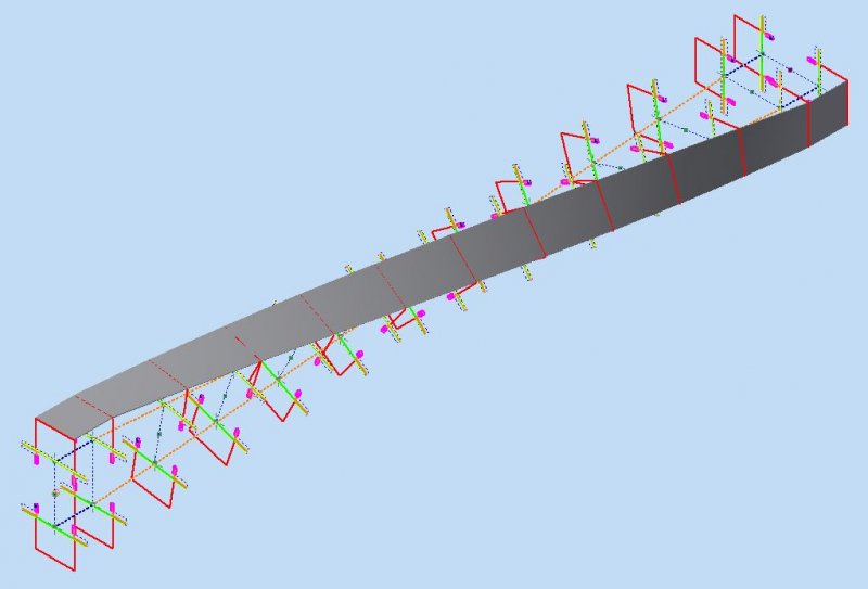

can you please help with the following request:
Please see image, i am trying to model a spiral which as straight sections on each end. The sprial it self can be developed in sheet metal,
but once i added the straight sections the plate does not flatten. I think its due to the transition between the straight and the spiral
causing the issues.
Can anyone please help.

Hi
i have found a way around my issue, instead of using line + spline + line with coincident constraits i used tangent constraits inbetwwen the lines and spline.
By using tangent constraits it allows me to develop the plate.
Thanks
Hi Alan,
That sounds right, the non-tangent condition at the ends may have created a little ridge meaning that the face wasn't continuous. You might have also been able to solve it by adding a bend across the edge, but the solution you found sounds neater.

I am still having a issue with the development of the plate looking a bit odd, its should be a rectangle with two straight end sections.
But I think the tangent constraint seems to be manipulating the development by adding arcs to the flat plate.
I am not sure how to reduce the effects on the spline when using this constraints.
