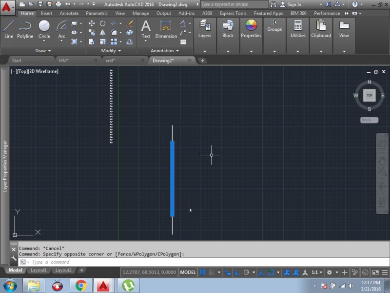

Hello guys,
I am trying to align a block onto a line by using measure or divide commands but when i do it the blocks appear all over the place but the line..
important is that when i select the line the blocks are also get selected..
like they are indeed on the line but they are not really shown on the actual line but somewhere else on the map..selected..
i know it must not be very complicated but since i just started, i could use some help.
Thanks.
If the blocks are all over the place one reason might be that their basepoints were not on some part of the geometry to begin with but that can only be verified if we can get an actual copy of the drawing you have created. So my suggestion is that you attach a copy of the drawing in question to your next post and someone here will take a look at it and tell you where you went astray.

Images are basically useless when it comes to troubleshooting a problem like this. Use the Go Advanced button for starters and attach a copy of the actual drawing you are working on to your next post.
Did you create these blocks? If so, did you pick somewhere on the block's geometry when asked to pick a basepoint or did you default to using 0,0,0?
Sorry for the delay,
I managed to upload the pictures after all..
It's only an example to show what the problem is.
Hope it'll work for you.
Thank you.
