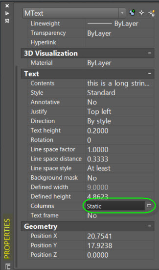

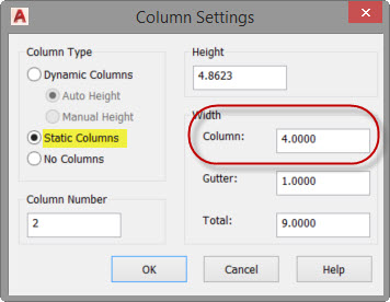

troggarf
I am wondering if setting the Column settings to a fixed width would help.
Even if you don't need multiple columns you can simply drag the length of the first column down to give it more room.
Select the MTEXT and in the Properties palette, click the dialog icon to the right of Columns in order to show the "Column Settings" dialog box.
Set it to "Static" and then set the column width as shown below.
~Greg
