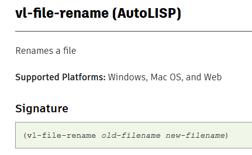

Can i hijack this thread and ask for a way to add a prefix or suffix to an image reference name?
start with SW_370000_8110000_1km etc. and end with SW_370000_8110000_1km_2023
Two steps, rename the file then update the image path in the dwg.
That all depends on if they want the file renamed. It seems to me they want to rename the reference which can differ from the filename.
