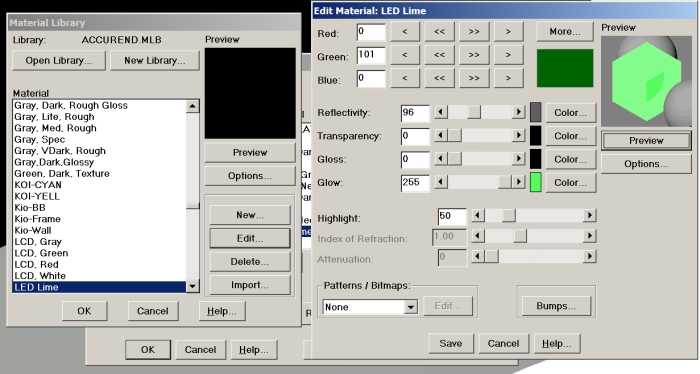

I played around with this a little yesterday in 2014 and did exactly the same thing with the green point light and a green plastic LED material but couldn't find a way to set the material to glow. I'm not sure if it's possible in newer versions of Autocad? My material settings are shown below.
The version of Accurender ( 2.0 ) I used does not have self illumination. It has glow. The next version ( 3.0 ) is just the opposite. Maybe they just changed the label
Yeah, the only options available in 2014 for self illumination are shown in the screenshot I posted. Autocad 3D really leaves a lot to be desired. In other programs it's very easy to create materials that emit light, but not so in Autocad. Maybe someone else knows of a way to do it, but I couldn't find a way.
