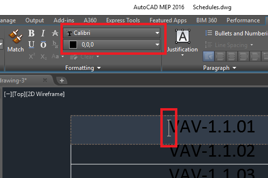

Reference the red outlines:
I brought in Tables from Excel via Paste Special > AutoCAD Entities so I could quickly copy/paste into one of my pre-formatted schedule styles. The problem is, you can't truly reset the entire Table because the contents exist one level deeper than the "Clear Formatting" function will go. The text has overrides inside the cell itself. Is there any way to completely reset all overrides, including the embedded cell contents? Thanks in advance!
