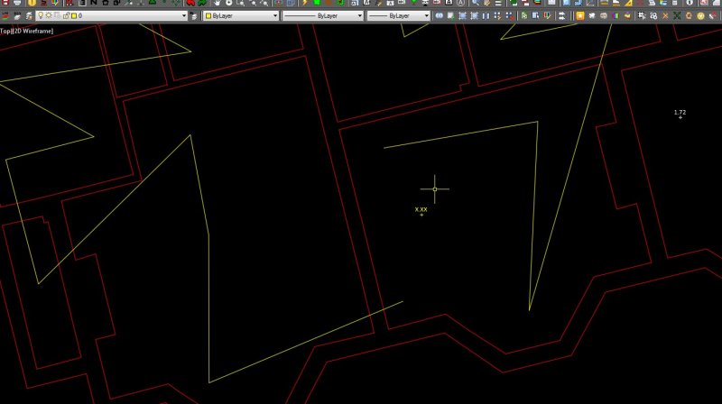

Hi, wondering if any of you clever people can help. I've browsed the various lisps on here for labelling the Z value of a point, but none of them quite do what I want...
I have a 3D polyline and I want to add a label at each vertex comprising a level cross (ideally using my existing cross block) with a piece of text centred above this giving the Z value. The complication is that I want my cross and its label to be 2D (ie. to have a Z value of 0) once it's been inserted.
Anyone feeling like a small challenge?? Thanks in advance, and obviously let me know if I've not explained myself well enough or you have other questions...

Can you post a sample ?
Screenshot of what I'm trying to label (the yellow line).

Can you attach a drawing with a 3D polyline labeled with the existing cross block you want to use?
Thanks for your interest, Tombu.
DWG file attached with the 3D polyline, level cross block and accompanying text for experimentation!
3Dpl_ZLabel.dwg
While I don't quite understand all of the details, this should get you started :

Thanks David - a good start, and I really appreciate the time you've obviously spent on this!
Couple of comments: [1] I would like to keep the values to 2 decimal places; [2] I also need the text and block to to have no Z value themselves after insertion (ie. to do this manually I would need to use the FLATTEN command). While I realise they initially need to use the same Z of the vertex they relate to, is it possible once the text contains the value of the polyline to then flatten them automatically?

David, with your help I've changed the 2dec places setting. However, I'm afraid my lisp knowledge is not good enough to really know what to do with forcing the text & block onto a Z of 0. I've done a bit of trial and error trying to add in your line of code, but not having any success...
At least you tried.
Change :
(cons 11 (polar v (* pi 0.5) (* txt 2)))
To:
(cons 11 (polar (list (car v) (cadr v) 0) (* pi 0.5) (* txt 2)))
Do this also for the (cons 10 (polar v .....) statement as well
-David
Thank you so much... and yes, I did try! I've also realised that I need to do something similar to force the block to Z of 0 too. Going on what you changed above, I was hoping that all I needed to do to accomplish this was to change the line:
(cons 10 v)
to
(cons 10 (polar (list (car v) (cadr v) 0)))
but that hasn't done it. Am I close?
