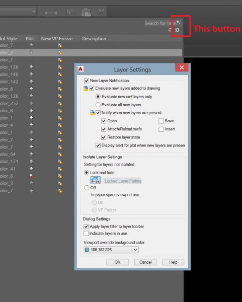

This button.

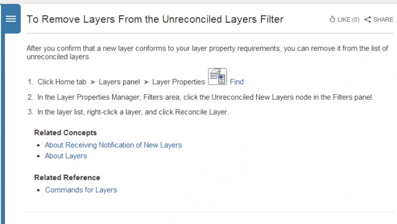

Either turn notification off, (see first image) or check the settings items the way you need, to get the layers reconciled.
It is not enough to merely view the list of unreconciled new layers. While you are in the layer manager they must be reconciled(see second image).
While reconciling layers in the layer manager, you can hold down the shift key and click on the first and last layer, to reconcile them all at once.
Reconciling the new layers allows their properties to be brought into your drawing. Whether or not the properties of the new layers will work with your plot set-up, can then be dealt with.
