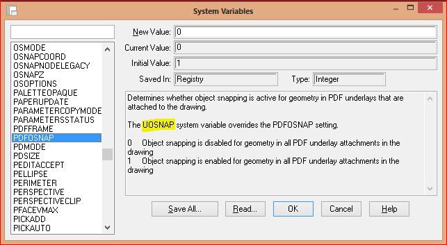

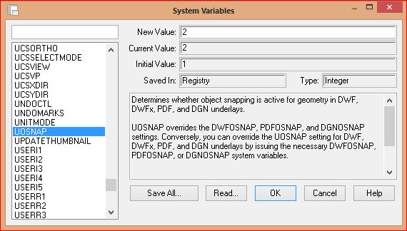

You are aware of the PDFOSNAP & UOSNAP system variables?
Thanks for your profundity Dadgad. Will PDFSNAP work if I convert my JPEG into a PDF?
PDFSNAP does not work on a PDF of a JPEG.
