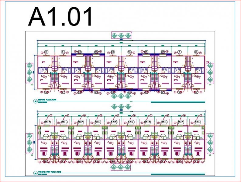

Hi, I got the cad files from the architect and used it to develop our shop drawings. On the floor plans, the notes / attributes shown on the floor plans are not visible in the paper space. I checked the properties of the layers and none of them are frozen or turned off. Can someone help tell me why they are not shown in the paper space?
I have attached the cad file below. the file is in 2013 version.

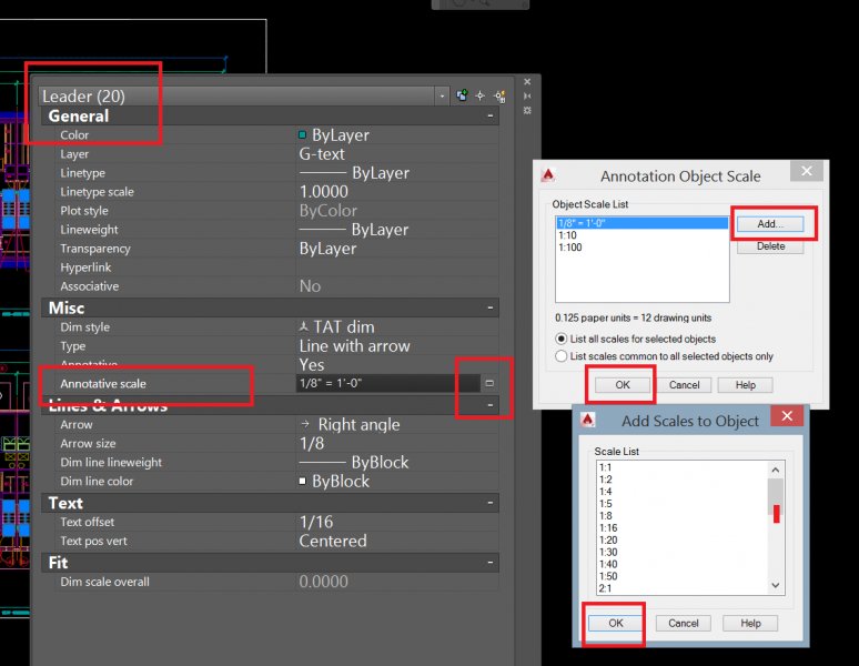

Because these are annotative objects, and they do not have the viewport scale associated with them. By the way, the viewport came up with no particular scale assigned to it. It should be 1:100
I added the viewport scale to a few of the objects, and they show now. I re-attached the drawing. Careful where you save it, I did not rename it.
To fix them select them, ( I used SELECTSIMILAR to select all like objects at once) Then open properties, click on the button at the end of the Annotative Scale line item, click Add, click the scale of your viewport you want the objects to appear in, click all the OK buttons.
See image.

The polyline in paperspace is not a Viewport.
I created a viewport in paperspace, and if you reset your ANNOALLVISIBLE system variable to 1, all of those annotative bits in modelspace will display in your viewport, regardless of the scale of the viewport.
There was a viewport there. it is the result of creating a viewport from an existing polygon (the rectangle). They don't get their own frames when you do that. The drawing opened in modelspace through a viewport that already had its extents zoomed off screen.
