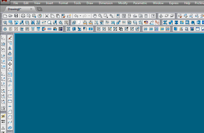

Hey,
This is a weird recurring issue I am having, it will be resolved after restarting the ACAD session, but it does return.
When picking a command (or any item) from the menu, the current viewport will not re-activate (I have to click into the viewport to get it to activate). This is not normal.
ACAD 2014 64bit, Windows 7 64bit, model space, 1 viewport.
Please see GIF animation below demonstrating issue and also another showin normal behaviour.
Problem:
Normal:
Has anyone seen this before and know of a way to either fix it permanently or know what causes it to happen?
Thanks for any help.

Might this be related to the number of drawing tabs which you have in the drawing?
In the bottom GIF you have only one, and all is well, in the top one you have multiple tabs, and you are required to stipulate.
I agree it seems odd, as it is being displayed, but that is the only conspicuous difference I see?
Presumably when you restart Autocad, there is only one tab, and no problem.
Maybe there is a threshold number of tabs, which triggers this undesired effect?

I don't believe the number of open tabs is the issue, I have since tested a fresh session with multiple tabs (same number and also more than first GIF) without any issue. It's probably just a matter of time before the issue returns. The tricky part is figuring out what causes it.
Ps: do the GIFs display/play ok? I've got the hosted on Photobucket, which can be a bit flakey.
Is it a graphics memory issue of some sort?
I've been dicking around, and looking through system variables to see if anything jumped out at me, but I don't see any likely culprits. :|
It is always hardest to debug when you have an intermittent problem like this, since you are not changing your settings, and yet it happens.
Might you be using a lisp which changes a relevant but elusive setting?
RIBBONSELECTMODE setting?
I reckon it could be a memory issue, or even a Windows issue. Though I really have no idea.
I haven't noticed any other new strange behaviour in other programs (or Windows itself).
RIBBONSELECTMODE doesn't seem to have an effect.
RIBBONSELECTMODE was a hail mary pass, as unlikely as it sounded. :|
The good news is, that as annoying as it is and much as it breaks your flow, you have a workaround.

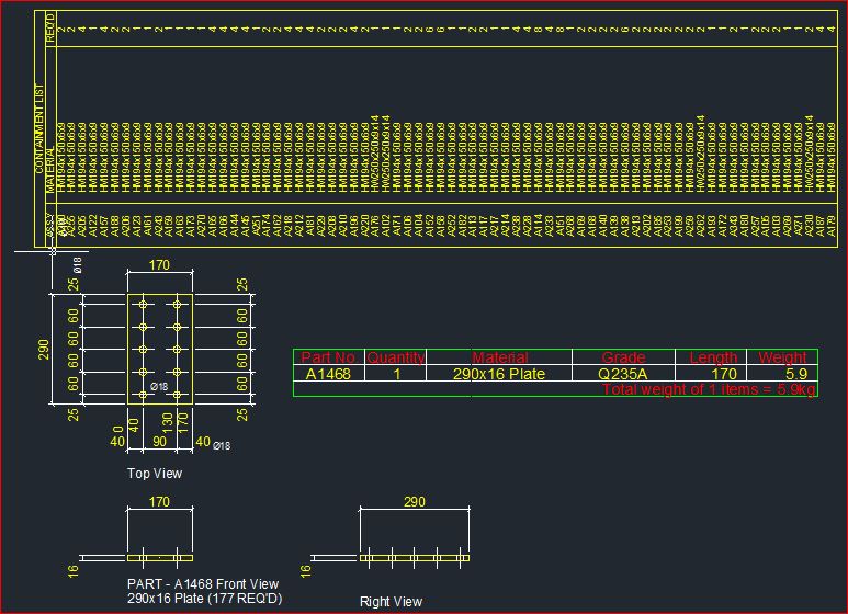

I wish the Containment List outputs included a total for a particular item. On some of ours, when I am doing the first check of containment totals versus drawing totals, and item weights, I occasionally get ones with as many as 800 of a part, and I have to confirm the total, which is rather tedious, being a list of 60 to 100 different numbers to be added oldstyle.
One of the reasons we wind up with so many layers is that each Xref brings a bunch. We have had as many as 1800 layers in a drawing, but when things are going well, we would have about 800. Which is still a hell of a lot of layers to have to wade through, and set layer visibilities for with great regularity.
Oh containment lists are a not well implemented.
For fitting drawings like the example you have shown... I would have the total part/fitting quantity display in the material list, and not show the part text below the item, but that is just our convention and either way works. Out of curiosity... why do you only show a quantity of 1 in the material list, but have the true quantity in the part text below?
As far as comparing containment list and part quantities, I usually copy the containment list out to the side of the drawing, then explode it a few times (to get text items), then use a LISP routine to add up the values of each assembly quantity. Saves adding each assembly quantity manually.
This is for the fabricator, and gives the weight of a single item.
This is obviously a splice plate, which will be used on a great many (as identified in the containment list) assemblies.
The group drawings, showing the complete assembly, have a cumulative total for all of a particular assembly.
Usually I can add them pretty quickly in my head, as regards the containment list totals, but for things like splice plates, clevises and stiffener plates, the lists can get pretty long, and may be up to 700 or 800.

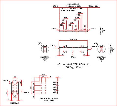

The style shown is similar to how we have done it in the past, I will post a little screenshot to show you how we did it before switching to ProSteel. You will see the resemblance to how we have chosen to do it with ProSteel. In the past there were no Single Part drawings, as subparts of assemblies, they were all put together on each drawing. For the fabricator however, it is very helpful to know by looking at a single part drawing, how many they will need to make of a specific bit, for the whole job, instead of a by the assembly total, like in our old style.

Do you (and your fabricators) prefer the system of having assembly and fitting drawings separate? This is the system I was taught when I first became a detailer, but we get the odd client here and there that would rather have all parts detailed on the assembly drawing (eliminating the fitting/part drawings completely, and reducing the number of drawings for the job) - just like your old system. I think this boils down to the difference between structural and mechanical detailing conventions (in Australia at least).
I am sure that our fabricator likes that we can spit out the fabrication drawings for tall buildings within a week or so of having completed the modeling, and with no human induced errors, like hole diameters misstated. We save at least one to four months of our hard work right there, which gets it into and out of the shop much more quickly. When talking about fabricating 1,000,000 pounds of steel, and trying to get it on site in a timely fashion, and since the architects always sign off on project geometry just about, if not after, the time construction was intended to start, that certainly helps.
All of our Standard drawings of parts which were designed for previous jobs and have come to be go-to parts for our new projects, are on sheets like the one I posted, with all assembly sub parts included on either the same sheet, or on as few additional sheets as needed to detail it clearly, typically one.
A reduction in drawing number is nice, but likely offset by not having to go through them and total common parts from the whole lot, which would be quite tedious. Our fabricator will farm out individual parts to other large factories in the area, if they need to, which is pretty much the norm, as they are very highly regarded and stay quite busy.
Personally, I love getting to do some real drawing, but all the more so, when we are not under the gun, because the job is already way behind schedule, and we still have a lot more to do. When we drew everything with AutoCad, we might be looking at doing 500 to 600 drawings in a big rush, with a small team, and we worked pretty long hours, and then we needed to laboriously check them all. It was definitely a lot more labor intensive than using ProSteel. :beer:
