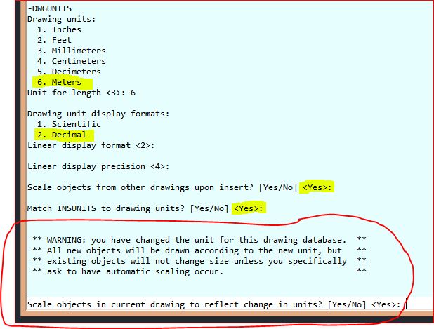

It seems preety straight forward but it confused me . In units, when i created decimal type and insertion scale mm and created a 5 unit line ..and then i changed insertion scale to inches and created 5 unit line...surprisingly,both lines were equal...again i created engineering units and insertion scale inches, feet ,mm,cm and so on and created 5 unit line... opposite to my expectations all the lines were equal in length whatever the insertion scale is? I know i am not underatanding the concept of insertion scale... expecting someone here to clarfy about this issue.... thanks in advance

Thanks Dadgad... i am using metric template... i want to draw in meters... like imperial templates where we can draw line in 5 feet by typing 5' and 5 inch by typing 5.. similarly in metric template i m only able to draw in milimeters..... what i have to do if i need to draw in meters for examle 5.6m line.... i dont want to type 5600mm....

If you pay attention and do this right, when finished you will just enter 5.6 if you want a line drawn which is 5.6 meters long, as your new drawing units will be meters.
