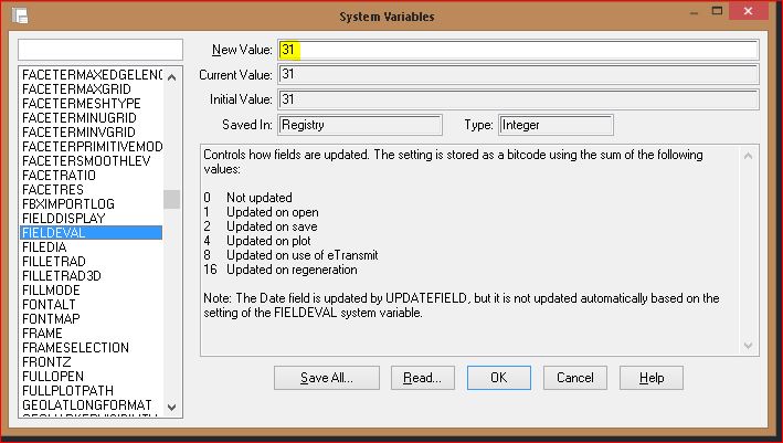

I would suggest you to check out the FIELDEVAL variable.
Hi,
FIELDEVAL value is 31.
FIELDEVAL setting of 31 means that just about anything should trigger the change, so it looks like we will need to fix it another way. :|
