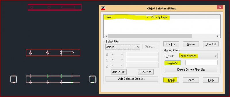

It worked for me, with the Filter defined as shown in the screenshot of the dialog box.
I then used the SAVE AS button to add it to the drop down list of saved filters, making it easy to use another time.

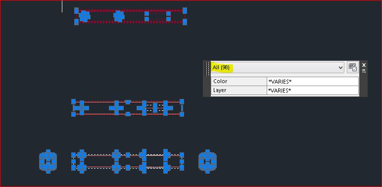

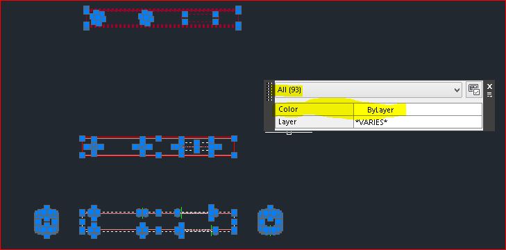

Compare the Quick Properties item totals, they correctly identify a total of 5 items for which the color is not defined by layer.

After you have selected " COLOR =" be sure to click on the SELECT button, and choose BY LAYER in the SELECT COLOR dialog box, then click OK, don't type "By Layer" into the available box on the Object Selection Filter dialog.
