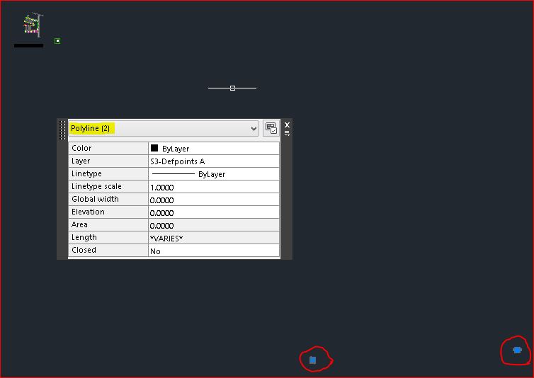

I found 2 lines, one about 2 units and one about 2.4 units long, at these coords, X=9458.8428 Y=-5674.3488 Z= 0.0000; at point X=9460.8897 Y=-5674.3488 Z= 0.0000 and residing on this layer: "S3-Defpoints A"
Hope this helps. Usually these errant things are empty text or zero length lines.

Right on the money dt, as evidenced in the screenshot.
Virtual flotsam. :beer:

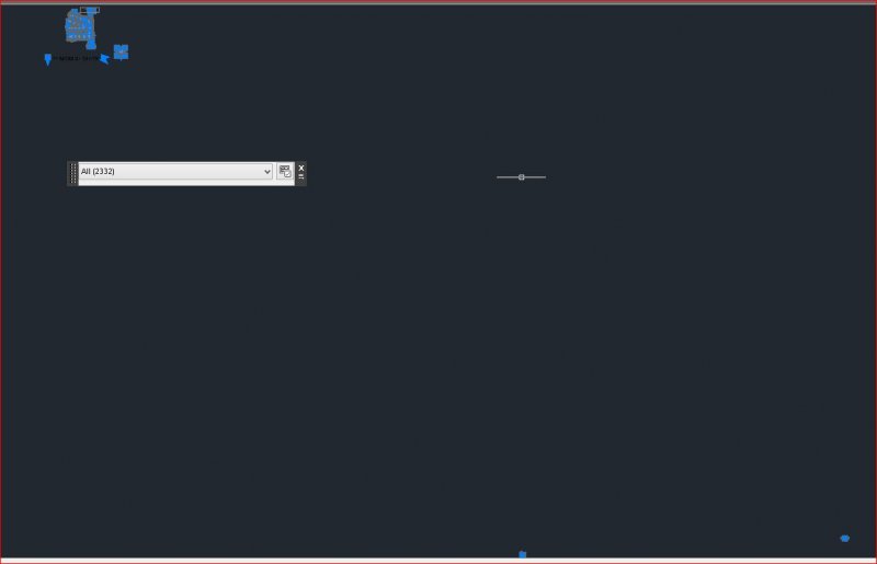

Another time try Zoom Extents, then do a regen, and zoom out a little bit further. Create a crossing window spanning across any empty corners of the previous zoom extents (since the fact that those corners were included in the Zoom Extents indicates that one or more of them, or the common area between them, contains the most remote bits of flotsam), and anything hiding there should show up, as in my screenshot.
Using Ctrl+A (select all), as Dana suggested is an even easier way to light everything up, then they should jump right out at you. :beer: That is all I did to get the result shown in the second screenshot, very easy with Ctrl + A.

No block nor group, just 2 polylines, curious they didn't show up. :huh:
Weird. I checked include grips in blocks, and groups, and Show group frames, then they showed up. I also changed all the colors to something I could see on a black background. I found the two lines and erased them but still had modelspace zoomed all the way to Mars. I think there is something else out there.
I also ran Audit, fixed over 200 errors and erased one item. There was a hatch with something wrong with it's border. I think that is what got erased. But my copy is still zoomed out. I have two large bunches of stuff about 500 miles apart. I may have broke it even worse. I can't re-create it because I deleted the file.
