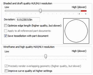

On Document Properties/Image Quality what are your settings(screen shot).

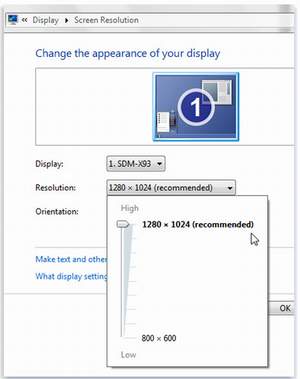

Display Settings 1280 X 1024
Video Card Nvidia GE Force GT 610
OS Win 7 64 Bit Home Basic
how in your first post did you have it set to 1600 x 900? that is a 16:9 ratio but the 1280 x 1024 isn't. That would cause the distortion.
The screen shot that you see is how it is set now, it is the recommended setting and it is still distorted So what should I set it at?
interesting. I have a very similar monitor to that. an HP w1907. Looking at your product specs the factory default is 1600x900. Go into the monitor settings with the Menu button on it, Navigate to "Image Control.." In there check what the scaling is set to. it is probably set to "custom". You should have the option to "fill to screen" or " fill to aspect ratio". Take a look at these settings and let me know what each setting does for you. Also at the bottom of that menu it will tell you the current resolution and hz update rate. See if that says 1600x900 60hz or if its at 1280 x 1024. I am wondering if the monitor is trying to distort the 1280 x 1024 to fill it to 1600x900 or something odd. Everything else should be fine so my only guess is the monitor settings.
Our graphics card detects the monitor and sets the max resolution, which is 1280x1024 but we are using older square LCD monitors. It will be a function of your graphics card to support a new monitor, we played with some new wide monitors and had similar problems taht the graphics could not match the screen ratios. Check out Nvidia perhasp for some newer drivers that may allow the card to support a 16:9 ratio but it may drop slightly in res.
