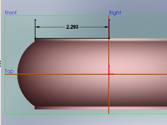

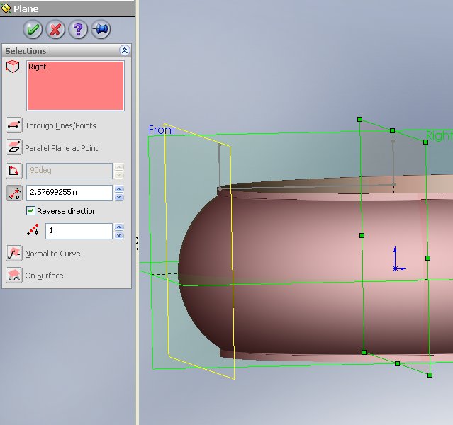

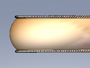

I am really not qualified to be giving advice on Solidworks, in that I am not certified, however I have had very similar issues with the Wrap feature in the past, and I am happy to share what I have learned the hard way.
I have found that to be very careful moving the plane over the tangency of the curve in preparation for the sketch of the extrusion pays dividends. What I do is to take a measurement from the plane's existing position to where you want it to be, then add say .002" to that measurement and move the plane to exact measurements. Also take care to have the sketch fall within the boundaries of the surface, lest failure will occur. I will try to add attached images to show what I mean.

Chubaraka, that shouldn't be the case. Solidworks allows you to use the Wrap tool with only closed sketches on a plane that is tangent(when parallel) to the face which you want to wrap to. This means if you have a full 360degree revolved cylindrical part you can use the FRONT plane without any offset. If you have something that wouldn't have tangency with your solid/surface when offset then you would have to create a plane.
There are a few restrictions/requirements needed. The part has to be planar, cylindrical or conical. It will work on "some" complex curve surfaces but this is where i notice that it fails. Typically you can have curvature in one direction. What i mean by that is you can take a complex spline profile and revolve it(making it cylindrical in one direction) or extrude it. But typically making it complex like a 3d boundary or lofted surface tends to lock up the WRAP tool.
