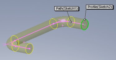

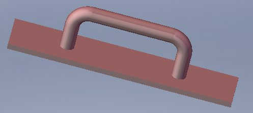

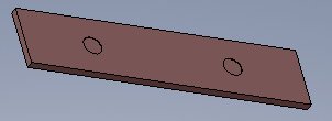

Solidworks offers many ways to do the same thing. I'll give you one way. Sketch a single line to the exact center of the side view of your handle by dimensions. Go into plane mode, Select the line then select any end-point, this will create a plane normal to and perpendicular to the line that you sketched. On this plane and the end point that you selected, sketch a circle to the dimension that you want the diameter of the handle. This is called your profile, and the single line you sketched is called the path, select Swept Boss Base and , select your path, and select your profile, hit OK and your handle will be created. You can mount the handle by assembly. Cut-extrude two round recesses, to the handle diameter, and .010" deep on the rear planar face of your shelled out unit where the handle should be located. mate the handle ends to the recesses and you should be golden.
