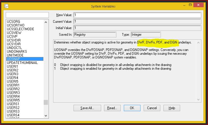

what sysvar is response to disabling snap to dwg underlay? i use UOSNAP=0 but it still snapping
Looking in SYSVDLG, it looks like you may be out of luck as regards an .dwg underlay, as highlighted in the screenshot.
I guess you could save a copy as a .DWF, and use that as your underlay.
i was afraid of that.:o
tx
