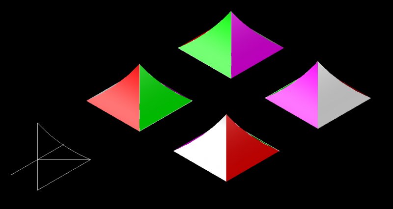

ReMark Posted June 3, 2016 Posted June 3, 2016 (edited) Obviously you did bother to research tensile fabric roofs. At least if you had you could have easily answered my first question. My attempt. Note that the four horizontal edges are straight. Edited June 3, 2016 by ReMark Quote

ReMark Posted June 4, 2016 Posted June 4, 2016 (edited) Maybe if the OP provided an image of some sort we would know exactly what he is looking for. The object I created was done using two arcs and the LOFT command followed by copying, rotating then assembling. After thinking about the problem a bit more I went back and took a different approach. Yes, it is possible to create the shape and have the four edges that run from the point at the top to the four corners be a straight (diagonal line) but the result, in my opinion, would not be suitable for a roof. On the other hand, I've seen some pretty unusual things pass as "architecture" today so It would not necessarily be out of the realm of possibility. Edited June 4, 2016 by ReMark Quote
sg7 Posted June 5, 2016 Author Posted June 5, 2016 Ok great! Yeah thank you ReMark, that looks like exactly what I'm trying to get. Unfortunately the idea was posed with only very rough sketches and bad black and white photos from the 80s that only slightly resembled the desired image. What you have seems like the correct design. I thought it was an interesting design. Each triangle is supposedly supposed to fit into another so that you could have a bigger roof with only a few more pieces. I feel like there is something off somewhere with the idea though. I did look up the tensile fabric roof. Like I said, it was close to what I wanted but not quite. This is what I did. Thank you for your responses. Mbita IDEA 8 by 8.pdf Quote
ReMark Posted June 5, 2016 Posted June 5, 2016 I think your roof would work if it were used on an open structure like a pavilion or a tent but not so well on a house. Note that in some places your roof dips below what would be the perimeter of the building. If you were to use this on a house then you must take into account that at some point it will rain. Where will the water go if the roof dips below the top plate? Quote

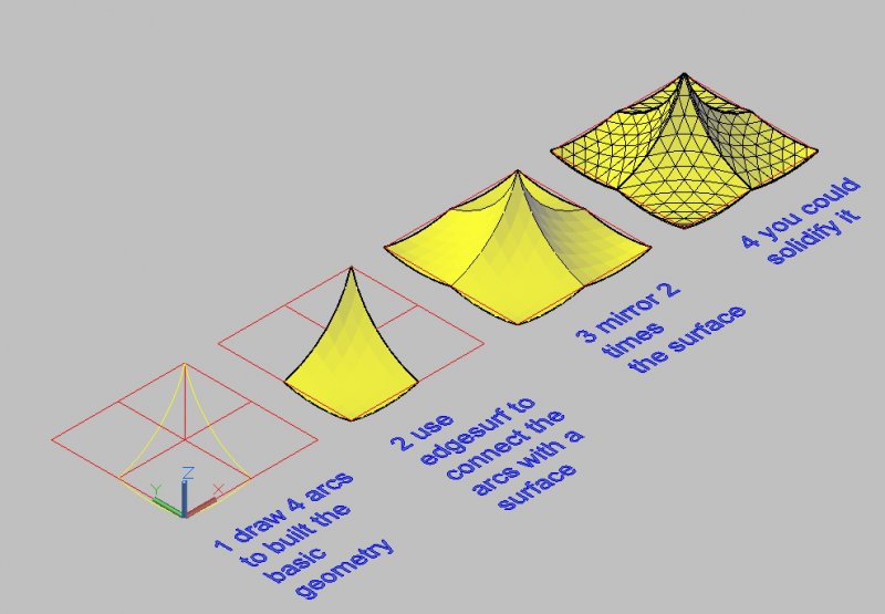

marmo Posted July 13, 2016 Posted July 13, 2016 It could be work with an edgesurf for 1 quadrant and then mirror 2 times. Quote
ReMark Posted July 13, 2016 Posted July 13, 2016 It could be work with an edgesurf for 1 quadrant and then mirror 2 times. Yes, we would love to see a demonstration of the technique you describe. Better yet, attach a drawing when you are done. Quote
steven-g Posted July 13, 2016 Posted July 13, 2016 A bit out of my league, but in your image the shape looks just like a section of a cylinder, I would try just slicing a tube Quote
