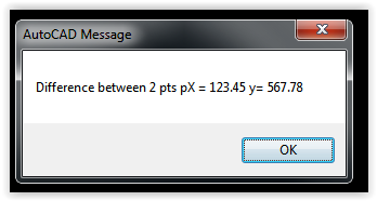

Hi again,
I found following code of Lee here and it is pretty close to what I need but I need to change it slightly to print X and Y coordinate differences (dX,dY) pair instead of distances. Can anyone help?

You have over 100 posts you should by now be able to do this mvery simple request yourself at least have a go we will help if you get it wrong.
You need to change this (setq tObj (vla-addText spc (rtos (distance pt1 pt2)) instead of distance get the difference between the two X & Y values
(nth pt1 0)
(nth pt1 1)
(nth pt2 0)
(nth pt2 1)
or (car pt1) (cadr pt1)

Thanks BIGAL for the motivation. The problem was that I didn't know where to look at. As long as you pointed out to that line of code, I think I cracked it.
See how did I go (perhaps it looks to medieval to you !)
