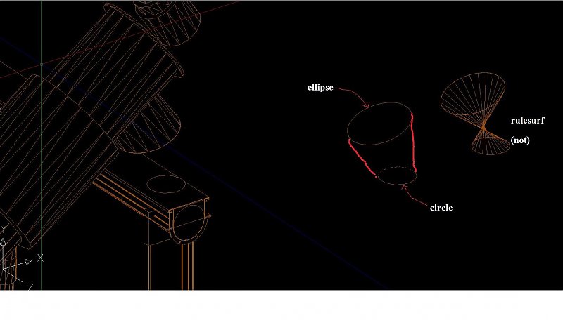

as per the attached, I need a transition or 'boot' for this classifier to hit the conveyor. The odd part is the 'ellipse' is at a slght angle and the opening in the conveyor is a true circle.
#1 how can I make a transition (what command am I lacking)
#2 how can you keep the mesh from 'twisting when doing a rulesurf. (I've experienced thes for mana manay years)
use the LOFT command. :)
I did but kept trying "guides", etc.....
I just stayed with the prompts and it worked. Thanks Styke. It looks funny in wireframe but is good when rendered...
:thumbsup:
the rule surf issue probably has to do with the selection process. glad you go it with loft.
