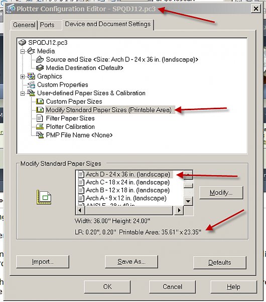

In your PC3 file for a particular plotter you will find that information. See attached. So select a paper size and then look down below to find out the length and width it can actually use.
