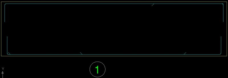

Dear All Masters,
I need two lisp programs one is Place lines as a stack with some minor offset. because my lines are merged.highest length of a line should be bottom or top and remaining lines are stacked by descending order by its length of line.please find attachment for clarity.
2nd lisp for length Labeling of a Poly lines or Ordinary lines with leader.please find attachment for clarity.
Please provide suitable Lisp code for this lengthy task for me.
Thanking you all.

Thank you for your valuable reply.
i have lines with overlapped and merged. so please do the code for separate the lines in y direction with small offset gap.without changing x coordinate values.

thank you for your reply. your code is not printed length of the pline it shows blank leader.
Sir,
please find below attachment and observe the lines of 1 & 2 Diagrams.
1 st diagram contains merged blue line. at 2nd diagram i have manually moved with move command with some distance. so kindly prepare the code for Merged to stacked lines.there is no change in X coordinates value, they are moved in Y Direction only kindly observe.
Auto lisp Code merged lines.dwg
Woops, sorry!
Thanks for mentioning this, this one should work:

I've had additional "enter" of the mleader command call - fixed.
I'm not sure what might the issue is, but the last edition I posted doesn't work on my uploaded drawing, but works on yours.
And the code in my #5 post works fine for me, but not for your dwg.
The only difference is this row:
(command "_.MLEADER" "_non" midpt "_non" (polar midpt (DtR ang) dist) "" (strcat (rtos obj-length 2 2) "m"))
(command "_.MLEADER" "_non" midpt "_non" (polar midpt (DtR ang) dist) (strcat (rtos obj-length 2 2) "m"))
And the difference in the dwg's that I've noticed is that you use "STANDARD" MLSTYLE, and mine is custom.
So one might want to change that row to this:
(cond
						((eq (strcase (getvar 'CMLEADERSTYLE)) "STANDARD" )
						(T
And it will work fine.

thank you sir, your code is good.but how to separate the lines? any code?
Sorry I did not noticed your second request. This is how I would approach it:
1. Specify spacing distance and direction Y+/Y-/X+/X- (or use getdistance)
1. Entsel the longest pline in the stack
2. Use the ssget "F" (fence method along its vertices)
3. Iterate trought selection, check if its pline on the same layer and construct a list of these entities sorted by their length
4. Move each element from the list, and increase the spacing distance (setq spacing (+ spacing spacing))
Unfortunately I don't know when I'll do that code as my desktop turned a big mess of .lsp files again, which I'm analysing...
So heres the code for your second request:
; Grrr wrote it, but the credits should go to: Lee Mac, Tharwat
; moves stacked plines from the same layer, by picking the longest of them, at a specified distance and angle
(defun c:test ( / ent ent2 pt dist spacing ang vla-obj vla-obj2 i vertlst SS obj-length)

It doesn't work exactly as I described in my previous post (the entities are NOT sorted by their obj length, so sometimes there might be unwanted results) - couldn't figure that out. And perhaps the code could be shortened.
Still it serves its purpose.
