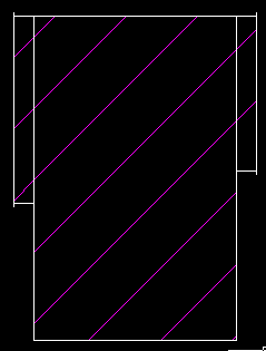

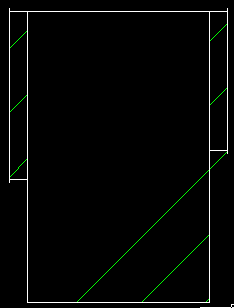

CesarA Posted June 23, 2016 Posted June 23, 2016 I have the following element, it's composed of a bunch of closed lines, altough the vertical ones at the edges go slighty beyond their limits. What i'm trying to do is select all of the lines call the hatch command the previously selected ones with the "p" keyword. However, I get this instead: Why? And how can I solve it? Quote
RobDraw Posted June 23, 2016 Posted June 23, 2016 Do not use Select Objects in situations like this. The hatch command wants to use the entire object. You've got a couple objects that you only want to use part of. Use Pick Points instead. Quote

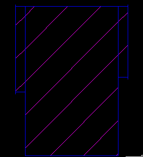

CesarA Posted June 23, 2016 Author Posted June 23, 2016 No, because i wanna select all of those elements, and hatch all of the closed spaces at once. It works when you have closed boxes, for example: Your answer makes no sense RobDraw. I've attached the example Remark Quote
RobDraw Posted June 23, 2016 Posted June 23, 2016 You answered your own question. My answer makes perfect sense. A hatch boundary should be properly closed. Those lines extending past where you want the hatch to end do not make a properly closed boundary like your "box" does. By using the Pick Points option, it will end the pattern at the first objects it encounters. AutoCAD thinks you want to use the entire length of the lines that are extending past the boundary that you want to use and is doing its best to give you what you are requesting. It doesn't know that you want to use only part of the object that you are selecting. Quote
