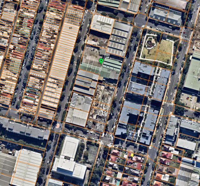

mvrcad Posted June 29, 2016 Author Posted June 29, 2016 thanks guys you see i sometimes put the satellite image in to cad and align it with an architectural plan of a building. then when i go to plot the drawing to pdf the file has been huge, so i have had to reduce the satellite images file size to reduce the pdf size. (thats a whole different story with bluebeam crashing and i am getting assistance from autocad with that) so Autocads suggestion was to reduce the satellite image file size. but, the image editing software i used to use doesn't come with windows 10... and reducing the images dimensions means i have to realign the satellite image with the architectural again... which is a pain in the @ss thanks all for your tips, ill give paint.net a go Quote
SLW210 Posted June 30, 2016 Posted June 30, 2016 Most of my large aerial images are attached into one drawing, I then xref that drawing into the drawings I use the images in. I have one drawing that is 143KB comprised of 6 18MB Aerial Images. They plot to printer and PDF just fine. What is the original file type for the satellite image? Quote
mvrcad Posted June 30, 2016 Author Posted June 30, 2016 Most of my large aerial images are attached into one drawing, I then xref that drawing into the drawings I use the images in. I have one drawing that is 143KB comprised of 6 18MB Aerial Images. They plot to printer and PDF just fine. What is the original file type for the satellite image? .png files. that's a thought, ill give x reffing the images in as a drawing Quote
