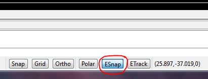

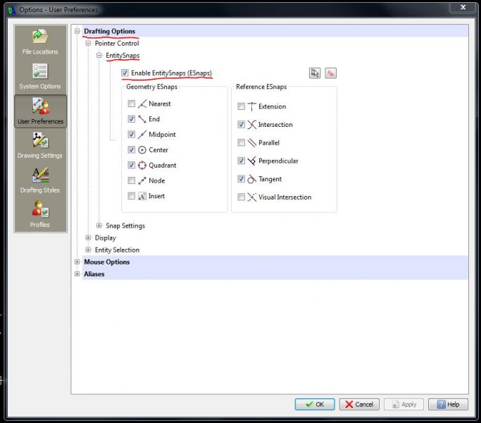

The feature you are looking for in DS is called ESNAP although typing OSNAP will also bring up the ENTITYSNAP dialog box. And this is what it looks like. You can also toggle ESNAPS On/Off using the button at the bottom of your screen and access the dialog box shown above merely by right-clicking on the ESNAP button then clicking on the word Settings.

Excellent! Problem solved. I had to go into the esnap setting and check the correct box. I activated all of them for now. Now i can get on with building something!!
