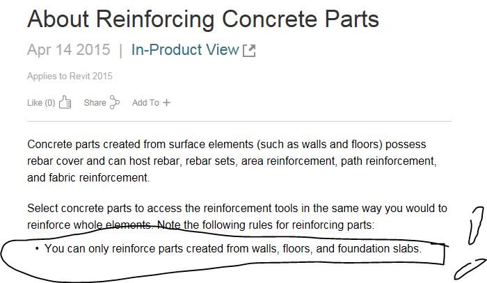

halam Posted July 7, 2016 Posted July 7, 2016 The abilities of working with rebar in Revit are limited thought. For use in civil constructions I believe in-place modelled shapes cannot be done with it. Can it, tzframpton? Quote
tzframpton Posted July 7, 2016 Posted July 7, 2016 The abilities of working with rebar in Revit are limited thought. For use in civil constructions I believe in-place modelled shapes cannot be done with it. Can it, tzframpton?I am in the AEC industry and have not used In-Place Families. I don't see why it wouldn't work though. I'm curious to test it. Quote
halam Posted July 7, 2016 Posted July 7, 2016 Please do. I would like to know your opinion about 'valid hosts' I believe default 'AEC industry families' as you might call them can be hosts, the ones coming 'out of the Revit Box'. for any more complex geometry Dynamo seems the answer. (read: Still have to programm it...) http://core.thorntontomasetti.com/dynamo-for-rebar-is-now-available/ https://knowledge.autodesk.com/support/revit-products/learn-explore/caas/CloudHelp/cloudhelp/2015/ENU/Revit-Model/files/GUID-A620B8CD-8F8B-45F0-924E-199FBE982183-htm.html Quote
tzframpton Posted July 7, 2016 Posted July 7, 2016 Hmm, that's not accurate. You can also apply rebar to Structural Columns. So... I created an In-Place Model of a regular column, and no rebar options. Did the same thing but made it a structural column and it worked. In-place Structural Column Model can add rebar. I tried it and it worked. It was a blended shape so very irregular and was still able to get it to work. Tried the same thing with an In-Place Structural Framing Model and it worked as well. Quote
halam Posted July 7, 2016 Posted July 7, 2016 How simple did you shape them? Please share some pictures of geometry. Quote

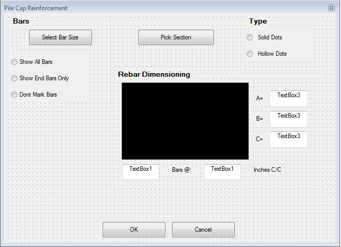

jonathann3891 Posted July 7, 2016 Author Posted July 7, 2016 Simple. As in, I just placed one just to see if it would or not. I did not try at all manipulating it. Side topics. It happens. No worries I downloaded OpenDCL and started designed the DCL, But struggling with everything else. The tutorial is vague in areas and the staff on the forums isn't very helpful. Anyone here use OpenDCL? Just playing with getting the lisp to call up the DCL, I can get it to show but I cant get the slide to load. Tutorial doesnt cover that and no useful info on the forums. This project may be way beyond my skill level already Here is a glimpse of my DCL *Not Finished* Quote
Roy_043 Posted July 8, 2016 Posted July 8, 2016 @ jonathann3891: Are referring to this?: http://www.opendcl.com/forum/index.php?topic=2303.0 Quote
Roy_043 Posted July 9, 2016 Posted July 9, 2016 @ jonathann3891: If you are unable to finish the OpenDCL beginners tutorial because there are sections you do not understand you should ask questions on the OpenDCL forum. Without the basic knowledge that you gain from this tutorial, you will have a hard time understanding the help, which I consider to be excellent, that is being offered. Quote
